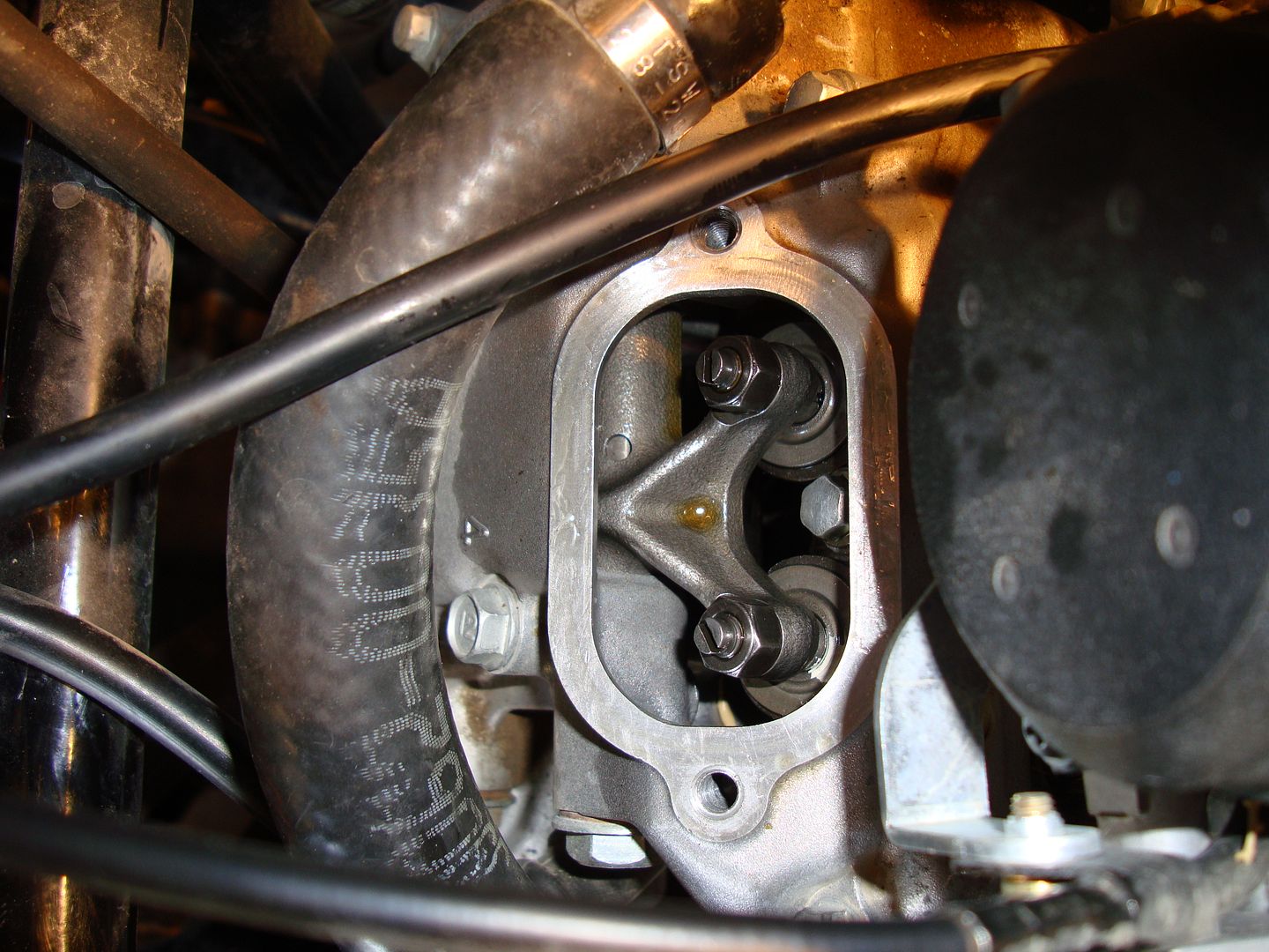

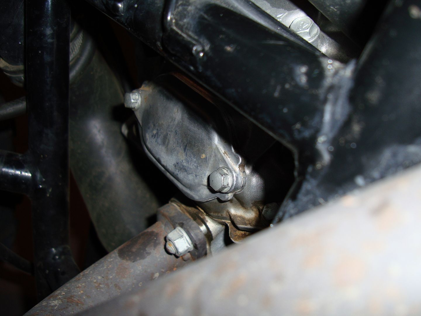

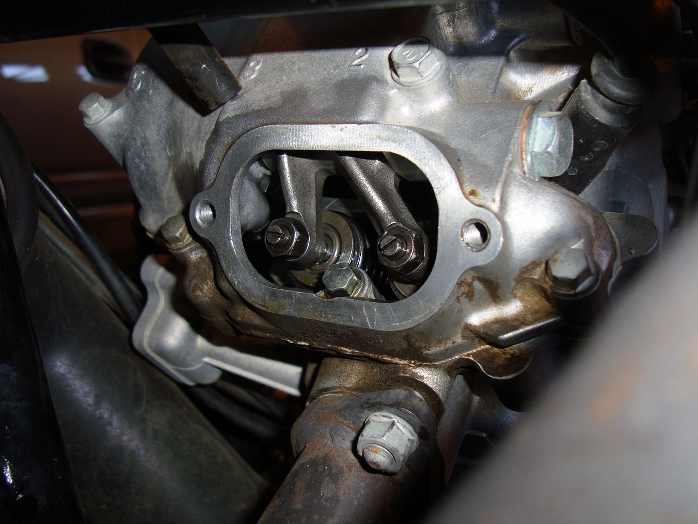

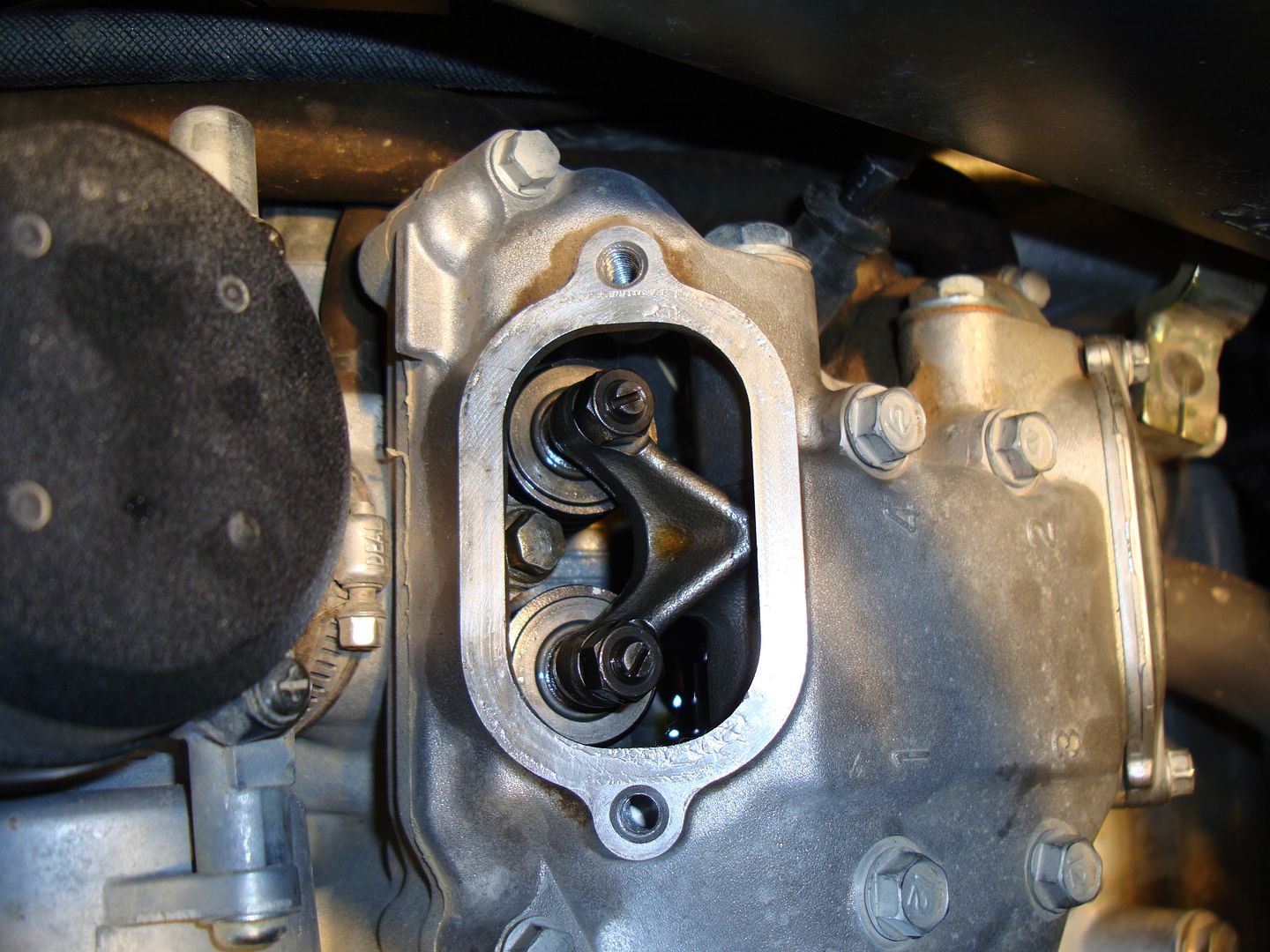

#11 · (Edited)
Pic Heavy !
Next time should go easier. :p
Pulling all the Tupperware was definitely alot easier access for me.
Took me 2 hrs. to get to here:
See Attached Thumbnails below
Then you get to these for the front INTAKE:Hope you have small hands
http://img.photobucket.com/albums/v514/hisfive/Brute%20Force/DSC04120.jpg
SMALLER hands to get to here for EXHAUST:
http://img.photobucket.com/albums/v514/hisfive/Brute%20Force/DSC04114.jpg
http://img.photobucket.com/albums/v514/hisfive/Brute%20Force/DSC04122.jpg
The rear cylinder valves are not bad:
http://img.photobucket.com/albums/v514/hisfive/Brute%20Force/DSC04118.jpg
You gotta have one of these:
.006" for intake and .008" for exhaust
http://img.photobucket.com/albums/v514/hisfive/Brute%20Force/DSC04128.jpg
*** I have recieved numerous PM's on where to buy these, you can get them here:
http://www.rockymountainatvmc.com/productDetail.do?navTitle=Tools%2FShop&webCatId=22&navType=type&webTypeId=140&prodFamilyId=23985&listingId=&sizeAttr=5759
Make absolutely certain you are NOT 180° out by watching the front cylinder intakes close, THEN continue to watch for your TF mark.
Same for the rear; TR.
Put back just enough to test fire it. Airbox etc. and bingo, one push of the starter, dead cold, she started immediately. Runs like a new scooter again.
Now, where's that bottle of red wine?
